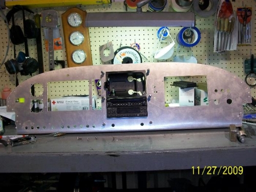

Brief Description:  Mounted Radio Trays
I received my SL-30 this week that I purchased from a dealer on Ebay. I got a good deal on it as it has a very small scratch on the faceplate. Other than that it looks new. I can live with it for what I saved. I really debated buying a Nav/Com as opposed to just a com since I'm not instrument rated and even this won't get the plane there, but it's what I wanted and it couples with the EFIS really well. When I made the rails on the Instrument panel, I extended them to the top of the panel so maybe some day I can get the rating.
Anyway I spent the day today mounting the trays in the panel so the faces of the radio and transponder are flush with each other.
Also, I made some new plates for the air vents that have enough room below them for the headphone and mic jacks.
I'm trying to get the panel ready to go to the powder coated next week.
