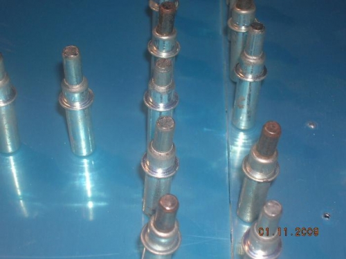

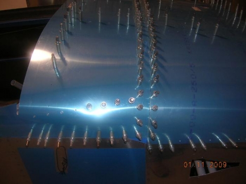

Brief Description:  Canopy Release and Frame
I installed the canopy release mechanism to the F768 bulkhead. I'm not putting the release lever through the instrument panel so I'll figure out how to work it when I get the panel done. I put the forward skin on and finished drilling the hinge points in the canopy frame, pressed the bushings in and had to trim the seal angles to increase the gap. From the looks of the gap between the canopy skin and the forward skin, I'll probably have to open it up some when I get that far.
