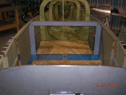

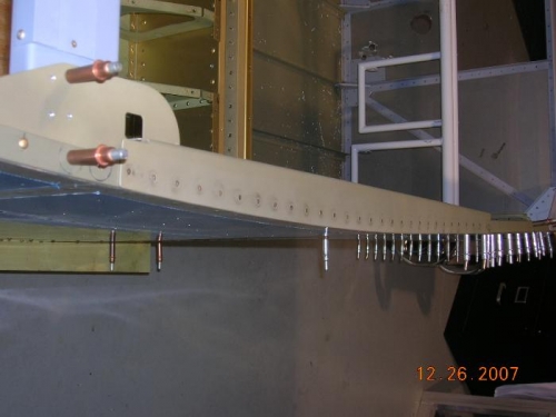

Brief Description:  Canopy Deck
Today I prepped the brackets for the tip up canopy and riveted them along with the canopy deck to the Longerons. I sent a note to Van's about the F-705G which is the big piece of angle the goes inside the F 705. It seems like if you rivet it now, there are about three rivets in the side skins that would have to be pulled rivets. On the other hand, I'm not too sure how I will rivet the angle in after the skins are on. Ken Scott said that it is one of the most problamatical parts on the fuse. They have luck riveting them on after the skins, so that's what I'll do.
