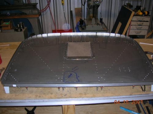

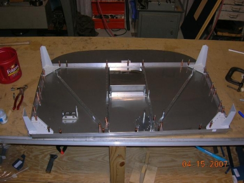

Brief Description:  Working on FIrewall
Today I went over everything I had done the other nite and fabbed the balance of the brackets that had to be made for the firewall. I then placed them all in position and match drilled thru the firewall and all the brackets. I then took it all apart and deburred everything, dimpled the firewall appropriately and machine countersunk all the angles to fit flush to the firewall. The parts are now all ready for priming. Depending on the weather, I may do that tomorrow or start on the bulkheads.
