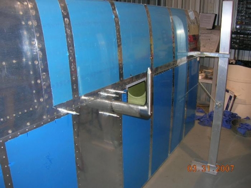

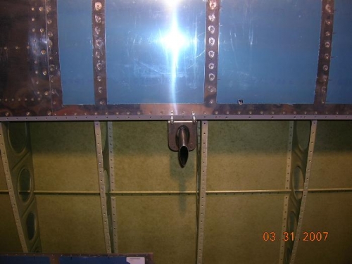

Brief Description:  Pitot mount
Obviously the date on my camera is incorrect for some reason, but this evening, I finished the pitot mount. I used a step drill to open the hole up then a carbide burr in my die grinder to finish the shape. More sanding with the dremel and I think its nearly done.
