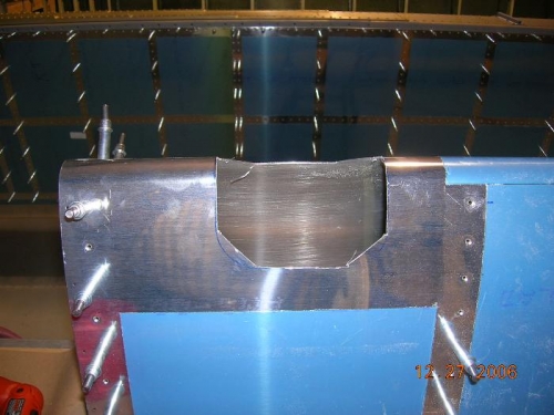

Date:  12-27-2006
Number of Hours:  6.50
Brief Description:  Right Leading Edge Work
Today I readied the Leading edge for the right wing for riveting. I had already fitted it and match drilled it so I deburred all the holes and the edges. I then cut the hole for the landing light like the one in the left wing and fabbed or modified all the associated parts. It was fairly nice out so I primed the skin and the strip that joins the tank and leading edge. After the primer dried, I painted the inside of the skin where the light goes white. This one looks better than the left one as I painted this one before riveting it.
