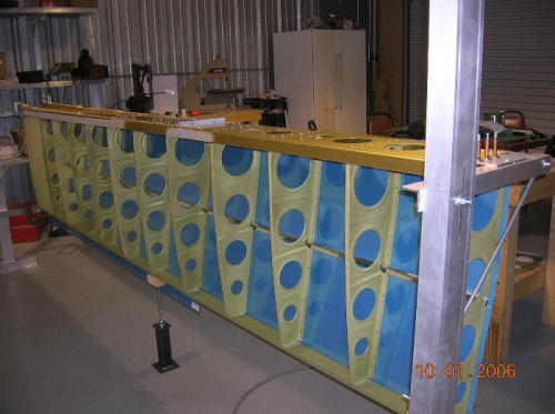

I made the wing walk doubler for the right wing and clecoed the skins on the top of the right wing. Then I began match drilling all the holes. It seemed like it took forever but it really wasn't too bad. I think my wing stands are a little low. They should have been a little higher. It would have been easier to work down near the rear spar. I finished match drilling both wings and cut the "J" stiffners for both while I was at it. I'm out of 3/32's clecoes until the order I placed with Cleveland comes in. It shipped on Friday so it should be here Tuesday or so. That's one thing I didn't think through when I decided to build both wings at once. The tool kit I bought would have been enough to build one wing at a time. I need to call Russell Sharpe, my TA, and get him to stop over this week sometime if possible. Next weekend is SERFI, and we're going to that to look at some of the TVRVG that I'm sure will be there. Also, my friend Jerry Thorne (AKA N2PRISE) is planning to come down.
Left Wing with Top Skin
