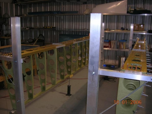

Brief Description:  Right wing in stand
I finished the rear spar on the right wing and put it in the stand and did some initial leveling. I got an e-mail from a fellow that's building an 8 and told me he had the same problem with the ceiling fan and the plumb bobs. His solution was to suspend the plumb bob in a container of water. That seems like a really good solution. I will try that the next work session.
