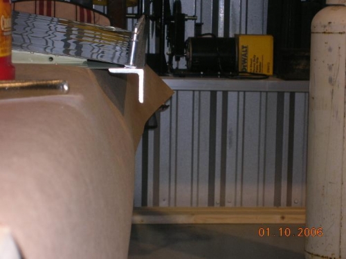

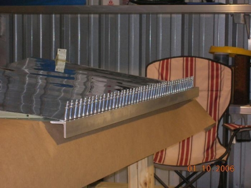

Brief Description:  Trailing Edge
I've been pretty worried about the trailing edge for a couple of days and finally decided to do the "proseal" thing. I put a note on VAF concerning modifying a couple of flush sets to allow the use of a pnuematic squeezer fo the trailing edge. I think I have more control with the squeezer than a rivet gun. Got mixed results back. We'll see what happens before I rivet it, hopefully yet this week.
It's Straight for Now!
Trailing edge, Prosealed and clecoed
