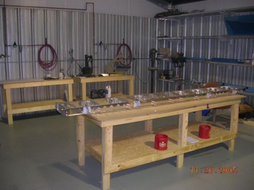

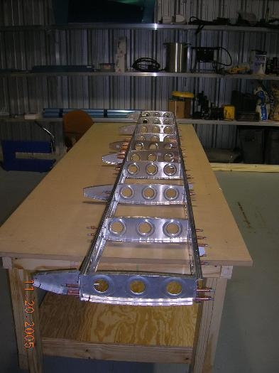

Rebuilt H.S. 908 left and right due to not being close enough to suit me. Clecoed and match drilled nose and main ribs to front and rear spars. Right side fluted, straightened and deburred all H.S. ribs.
