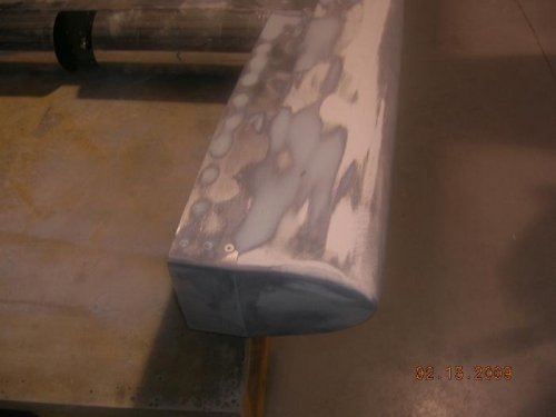

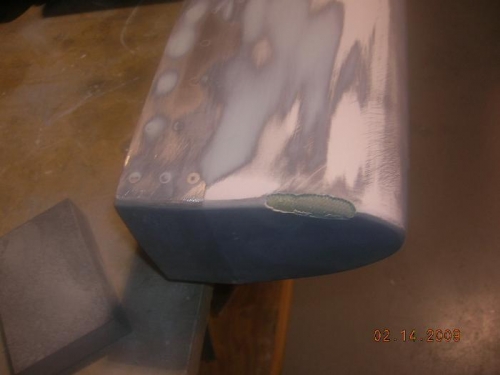

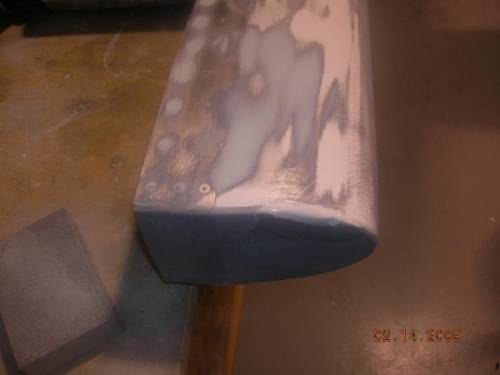

Brief Description:  Priming and filling
So this morning I shot a coat of primer on the elevators and let it dry. I then wet sanded it with 220 grit paper and the hole in the gel coat in picture one showed up. I mixed up some micro and fixed it and used some evercoat 416 to fill some imperfections. I'm not building a show plane, but I want it to be as good as I can do while I'm at it.
