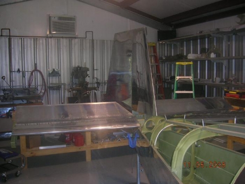

Finished mounting the Vertical Stabilizer but used temp nuts on the bolts as it will have to come off to go to the airport. Mounted the rudder. It was on and off what seemed like 100's of times to get the rod end bearings correct and the spacing correct from the VS spar. It appears that there isn't enough room for the bottom rudder cap to fit between the rear VS spar. I'm not very happy with the rudder stops yet. I will wait to work on it some more till later. Then I started on some other finish kit chores. I made the C-617, C618 and C-619 blocks and spacers for the canopy on the mill. I'm sure glad I have this equipment as it's so much easier to get the dimensions per the plans.
