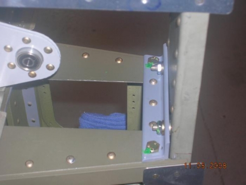

Control Rods
Put the ends in both elevator control rods . Set the bellcrank vertical and the elevators to neutral and set the nuts on the control rod. Removed the elevators and started fitting the Vertical Stabilizer.
