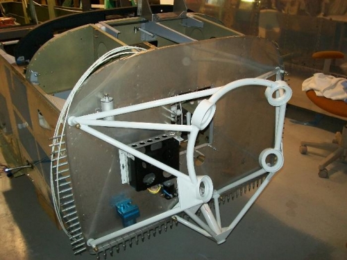

I started the day by making a drill bushing to fit the engine mount. I thought it would be easier to drill a series of holes up to the correct size than trying to drill a 3/8 hole first. I drilled the top right hole after holding it in place and looking to see how they lined up. After I got a bolt in it, Reva came out and held the mount while I drilled the rest of them the small size. They lined up with the pilot holes surprisingly well. I then proceeded to step drill them up to size. I had to grind down one of the bolts holding the fuel pump on as it cautions in the instructions. Once that was done and all the holes drilled I bolted it on and torqued the nuts and added the cotter pins. It's on and ready for the engine, sometime in January, I hope. I then soldered the wires on the headset and mic jacks and mounted them in the cover.

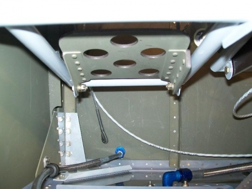

Also, I realized that I hadn't put the cotter pins in the pivot bolts on the brake pedals so I completed that today also.
