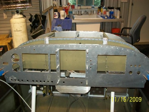

Brief Description:  Insturment Panel

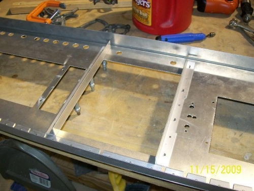

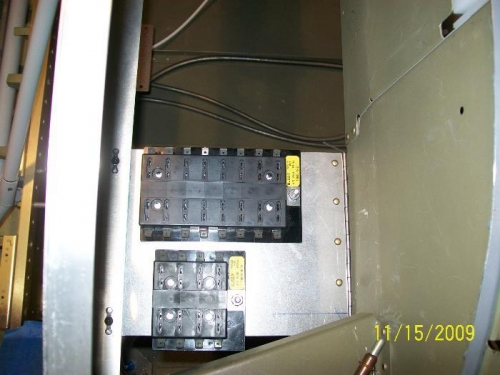

Fabbed a throttle/mixture bracket and installed nutplates on panel to screw the bracket to. No holes yet as I don't know how large they need to be. Drilled the panel for the intercom as I think I finally have a "final" layout. Made a hinged shelf that hinges on the bulkhead forward of the insturment panel and has a couple of screws that hold it in the up position on the bottom of the insturment panel. This is where the fuse blocks will go. Since it hinges, it should be easier to trouble shoot in the future. Mounted the magnetometer in the tailcone.
I made the rails for the radio rack and counter sunk the I/P for flush rivets to hold the rails in. I won't go any further with these until I get a radio.
