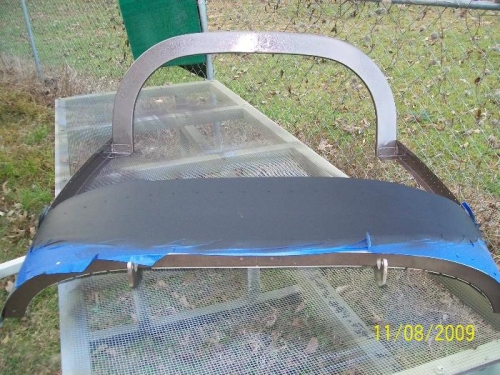

Brief Description:  Canopy Frame Work
Installed Canopy Latches and removed Roll Bar. There's no room to fit and drill the latches with the roll bar in place that seemed very accurate to me so I figured out a way to clamp the canopy in it's proper shut position without the roll bar in place. I worked really well. I did have to open the receiving holes a little to let them slid down freely. I will order some material to make some guides to help the canopy shut squarely.
