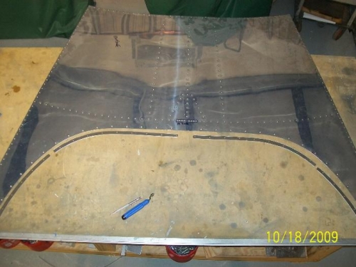

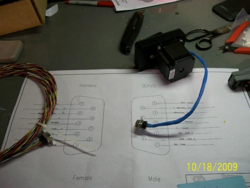

I finally drilled the last two forward most holes in the canopy to the WD-725's. Alot of people don't drill these due to it being a prime place for cracking. But after much head scratching, my canopy lays down so well in this area, that I can see no reason not to. It takes very, very little pressure to hold it onto the rails on both sides that I decided to use them. I think having the holes will make the skirts fit better. I dimpled the right skirt and c/s the right rail to accept the skirt. I then mounted the Dynon Pitch servo. I first put a DB-9 on the wires just like the one in the roll servo and wired it the same. I had previously did a drawing showing the pin outs for them which will eventually go into the wire book for our airplane.. When that was finished I made the backer strips for the rear window.
