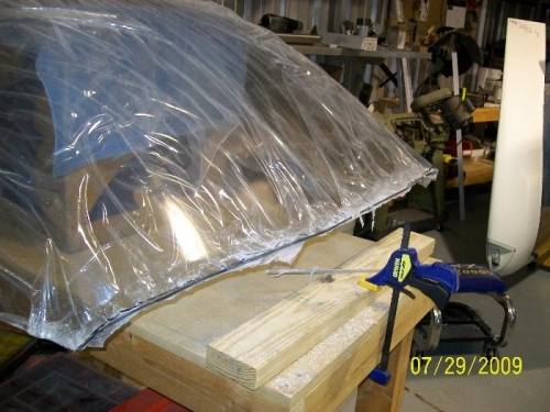

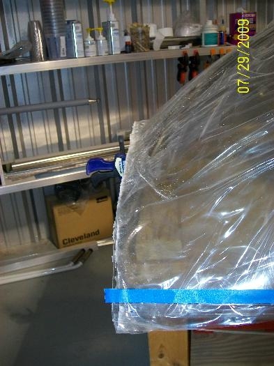

Brief Description:  Begin cutting canopy
I started to initially trim the canopy per the instructions. I marked a centerline and trimmed the front and rear to the clamp lines that were made when in vacu-formed. Sanded and cleaned up the edges. I've been dreading this canopy work as I've never liked to work with plexiglass. I guess if everyone else can do it, I can too.
