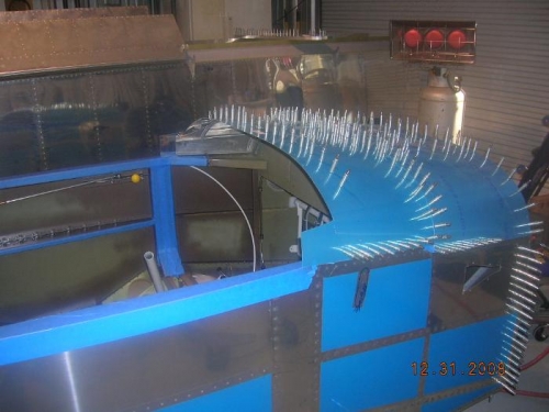

Brief Description:  canopy
I put the forward skin back on and put the canopy frame back on and with the extra clearance I made in the spacers, I was able to get the gap consistent at 1/32 between the skins. I then massaged the rear of the canopy to fit the fuse better and drilled the C-614 to the frame and clecoed it in. I had to quit for the morning as I'm going to Headland to see Al DeWeese's project this afternoon. He also has a tipper and is farther along than I am so I want to look.
