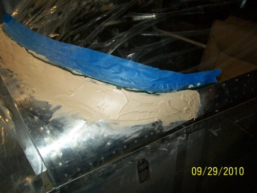

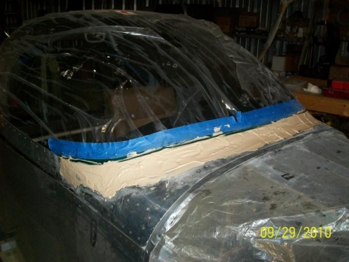

Canopy work
Finished sanding the glass cloth today and mixed up some West 410 and added to make a fillet. I also cut a sanding block with a radius of 4-1/4" to make the fillet just a little more gentle.
