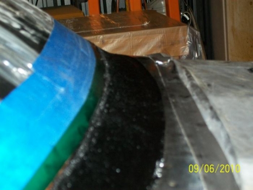

Brief Description:  Glassing Canopy
Reva helped me lay up the fiberglass. If I were doing it over, I would have used the flox more sparingly on the joint. I sanded a long time till I got it acceptable then, out toward the outsides it still wasn't very good. I made a sanding block with an 4" radius and that helped. I learned alot about this glassing business and I am sure glad I didn't build a glass airplane.
