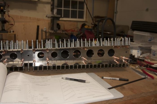

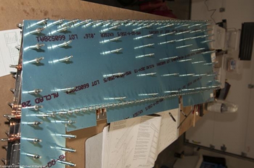

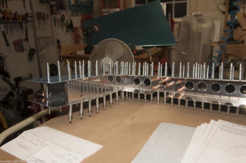

Deburr skins and cleco to the stiffners and rudder spar. In the middle of this, took trailing edge and trimmed it to fit the rudder. Cleco'd every hole in the trailing edge and in the spar. Noticed that the skin doesn't always sit tightly and need to move the complete rudder assembly to get the skin to sit right.
