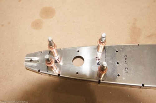

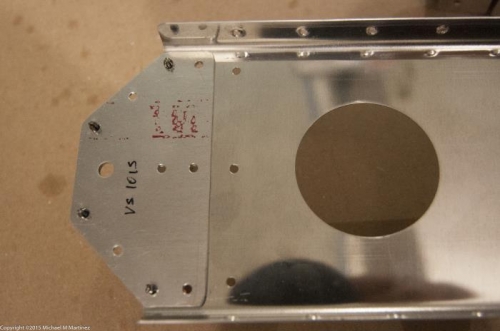

Clecod the Front Spar doubler to the front spar, final drilled the common holes, dimpled the bottom four holes on the front spar and machine countersunk the bottom four holes in the doubler. Took a bit to get the right countersink depth. Disassembled and deburred the holes.
Deburred all the holes in the front spar and dimpled the front spar flange holes that are common with the skin.

Drilled two more rivet holes in the VS-1006 and doubler plate. The others were drilled slightly too large and the extra two should provide more stability.
