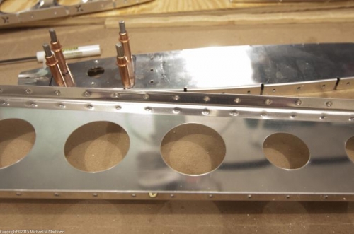

Finished deburring Rear Spar End Cap holes and final drilled the 3/16" hole in the rudder hinge brackets using the #12 drill.
