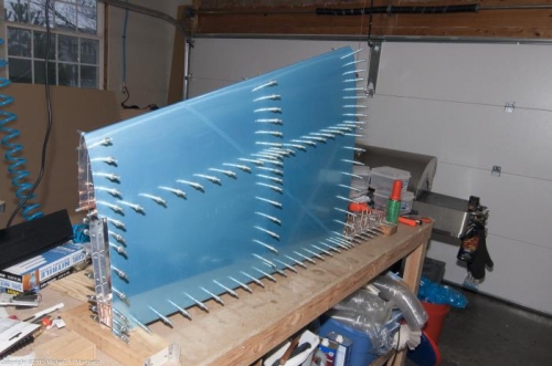

Brief Description:  VS Mods | Final drill common holes between VS skel
Final drill common holes between VS skeleton and VS skin using #40 drill bit.
Decided to do the following mod to the VS. Drill a hole in VS1006 top rib to accommodate a conduit so that I can run wire / cable to the VS tip fairing. This would allow placing a camera or antenna there and having power or comm or signals routed there later. Conduit ordered from Van's. The conduit will be attached to the VS using wire-ties and will not touch the VS skin. Parts ordered from www.mouser.com
