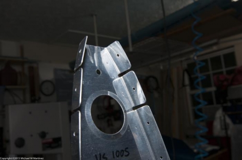

Brief Description:  Rib nose fit
Tried fitting the rib nose into the VS skin. Super tight fit in the front. Online, people have suggested trimming 1/8" off the front and fluting. Tride fluting VS1005, but I doubt its strength with fluting. Thinking of trimming using scotch-brite wheel. Need to call van's
