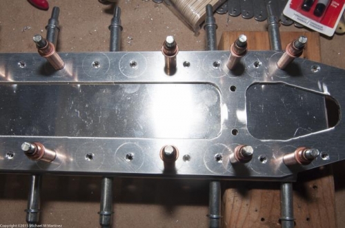

Brief Description:  Match drill attach bolt holes and Machine counters
Match drill upper attach bolt holes in rear VS spar, spar caps and doubler using 3/16" drill (step 5)
Machine countersink holes on spar doubler below upper attach bolt holes for 1/8"flush rivets
