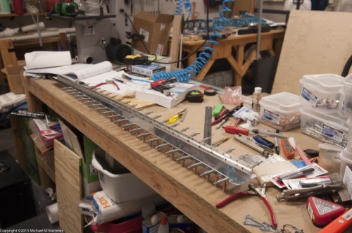

Continue match drill Rear Spar Cap
Match drill the spar end cap flange with #40 drill after deburring the 1/8" holes from step 2. Still need to deburr the flanges. Compressor needs to refill the tank after 6 - 7 holes.
