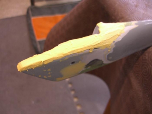

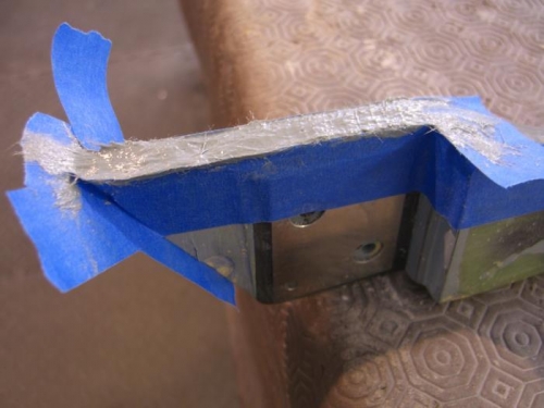

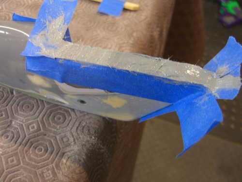

Brief Description:  Windscreen Bow
I continue to work on the windscreen bow, filling and sanding various areas to make the fit against the dash more even. The alignment plates bonded to the bow hold it in place very securely so I am hoping it will not move when the windscreen is finally being bonded in position.
Fine filler
Fine filler
Building up the forward face
Tape works well as form work
