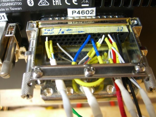

Brief Description:  GDU System ID
The G3X system with multiple GDUs (screens) requires configuration as to the function of each GDU, either PFD or MFD. I'm electing to have the left GDU as PFD & the right GDU as MFD (Program 1). This is performed by installing a link between two pins on the PFD J4602 connector.
GDU Left (PFD) J4602 pin 10 (PROGRAM 1) to pin 27 (SIGNAL GROUND)
Wiring diagram
Wiring diagram
Link, blue wire
Link, blue wire
