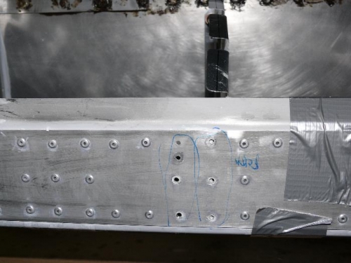

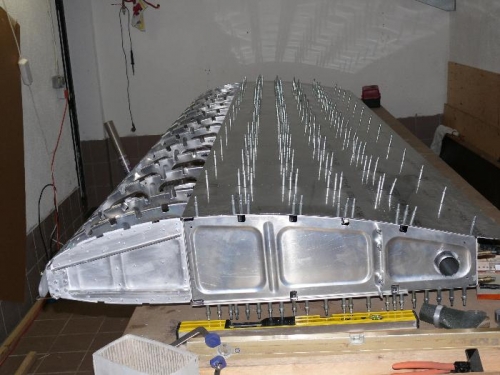

removed 6 rivets on LE spar because I mixed up the rib-spar rivert row, drilled out rivets and corrected it,fittted top wing and stringers, started drilling main ribs, It is easier to leave the tank skin for now
wrong rivet line/bend rib
top skin clecoed
