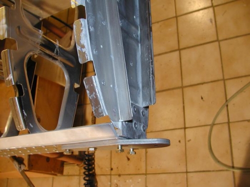

Brief Description:  LE root rib, front spar
riveted LE root rib,made a new packer( elongated hole), riveted front spar to LE ribs,

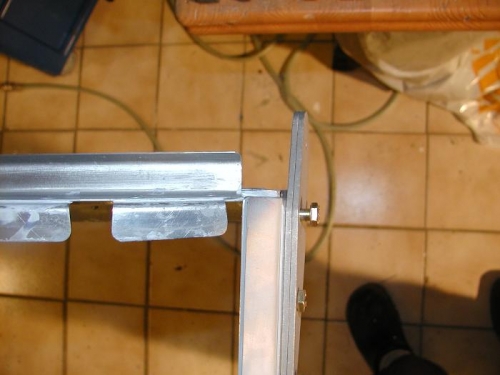

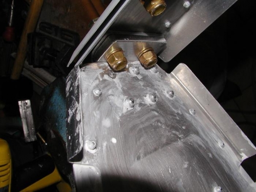

realised that W161 bracket from LE root rib to front spar is not flush with spar, had to remove one rivet, because it interfered with nut of front attach spar, should work if rivet is turned around,
will maybe add another bolt through front attachment if ok with MAM and Marc
LE to root rib &front wing attachment

bracket not flush with spar
Interference off bolt with rivet
