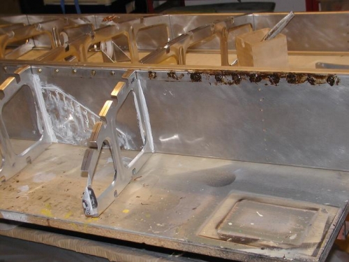

Wing skeleton assy
attached spar caps W117/W116, spar doubler, prep for riveting one bolt is AN5 instead of AN3(oversized hole due to close prox of prepunched rib hole!
First proseal experience
