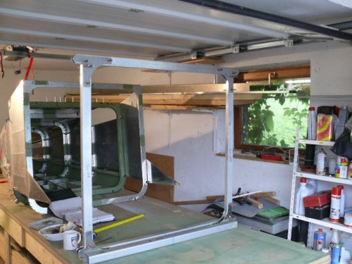

Brief Description:  joining of tailcone-cage
joined cage with tailcone, took me a while to aligne everything, once everything was square and parallel I checked distance btw wing fittings and noticed that my cage is one inch to short !!!!, I clecoed on hole to much btw FUS25 and FUS26. Guess was lucky to catch this in time,,,,
had to realigne everything, made stand for end of tailcone
