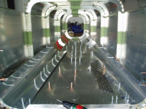

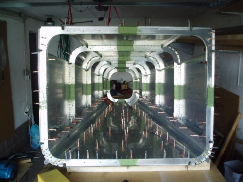

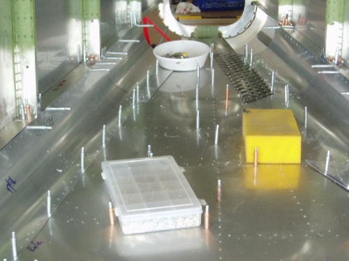

inner floor
drilled floor to channels,. started with corner wraps, I am not using a lexan template, instead I used " rivet hole markers", to mark the beginning and end holes of the channels, then I drill the other holes through the fan spacer.
