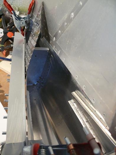

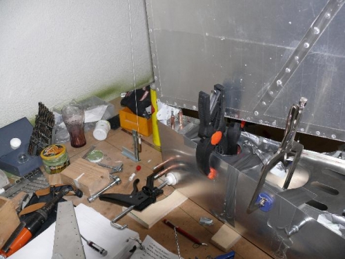

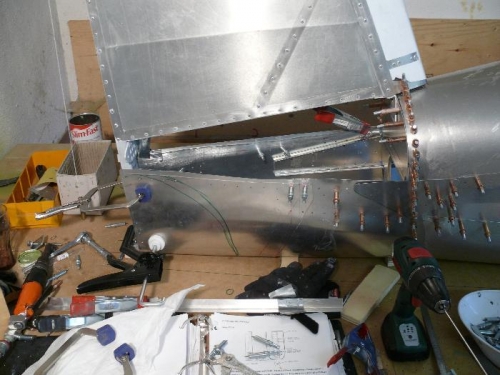

Brief Description:  tail wrap
redid fin to tail attachment, used new FUS30 tailwrAP (had two becaus doubler will be fitted over FUS 30 partially, will use missdrilled FUS 30 for doubler mod!.
realligned fuselage bolted fin securely down to table, and fitted new FUS 30 used same holes in horiz bh- lots of carefull backdrilling- long night...
