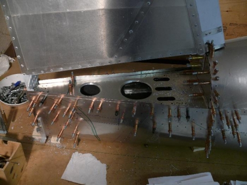

Brief Description:  tailcone
drilled no 11 holes for fin attach to FUS36, finished drillled all holes to #30, drlled holes for AN3 bolts in fin spar- temporary install, made cut push pull tubes for elevator, made doublers for elevator belcrank mounts( delrin bearings) and drilled appr holes
