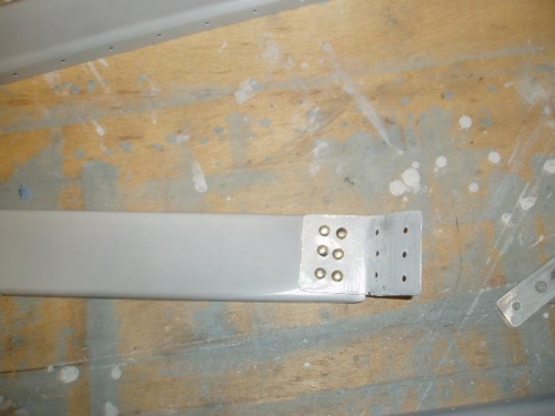

re stab
bolted hinges to rear spar, attach bracket to spar(wrong way around in the first time- bracket pointed outboard, noticed it when I fitted skin to web !!! BTW) started to rivet ribs to spar, used solid rivets(AN 470-4) for some ribs instead ov Avex
