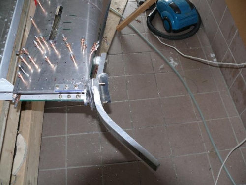

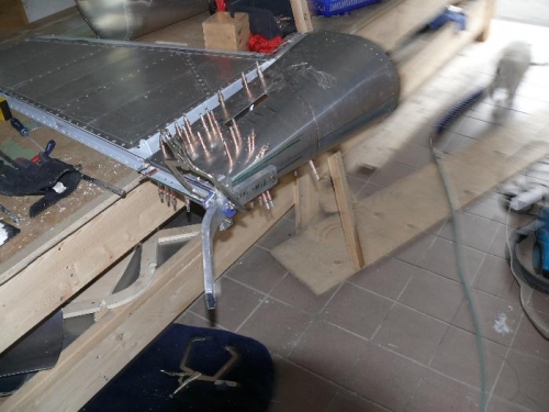

Number of Hours:  6.00
Manual Reference:  16
Brief Description:  tailsspring
drilled /reamed hole in tail to 3/8, drilled hole in tailspring,, drilled attachment plates and spacers to # 11
filed TS3 into shape,
had to ake a spacer under one TS 1, because they where not aligned !!!
removal ot tailsection and laying it flat on the table made aligning and drilling a lot easier
