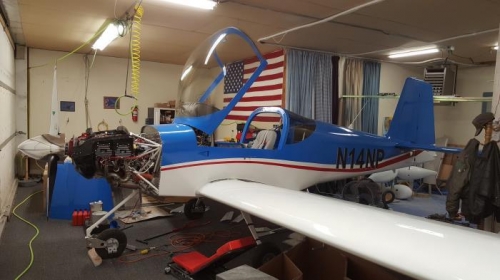

Brief Description:  Tourqued propellor. Installed spinner and seat.
Propellor tourqued to 66 lb and safety wired.
Installed the spinner.
Fueled the left take up to 5 gal and calibrated the gauges and a dip stick up to 5 gal. Then disconnected the fuel line and ran the electric boost pump. Was able to pump out all the fuel except unusable fuel which was less than a quarter of a gallon on the left side. Will repeat on the right side Monday.
She's starting to look like a finished airplane.
