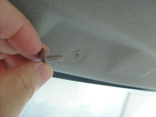

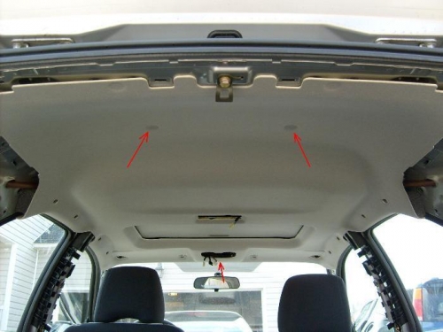

At this point, there are only three clips holding the headliner in, two in the rear and one up front.
1. Gently pry and wiggle the rear clips. When they're aligned just right, they pop right out. Until then, they hold tight.

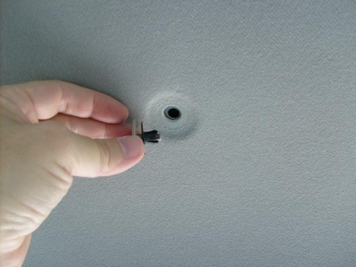

2. Not much to the front clip - just pull straight out.
3. Gently pull the headliner away from the door gaskets and then remove from the car.
Careful - the headliner is then and flimsy!
