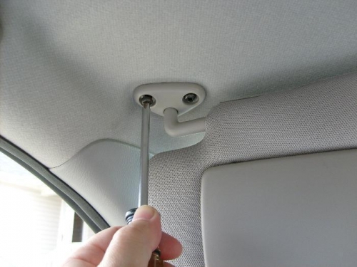

Sun visor removal:
1. Remove the two screws for the visor anchors and single screw for the visor clips.

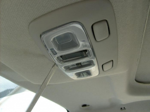

Forward interior light removal:
1. Carefully pop the clear cover off.

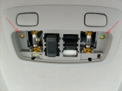

2. Remove the two screws.
3. Disconnect the power leads.

Remove the visors
Remove the visors
Gently pry cover off
Remove screws
Remove screws
