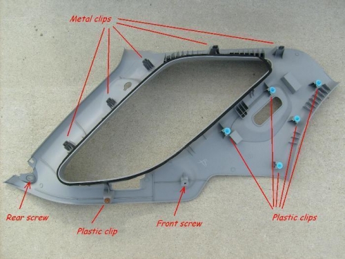

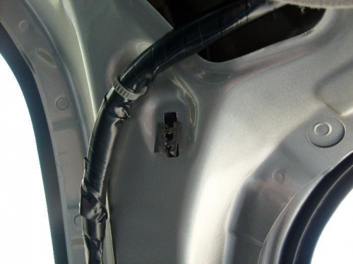

Here's what the back side of the panel looks like. Some of the metal clips don't want to let go. Use a pair of pliers to pull them out and re-insert on the panel.
What you're fighting on the back side
Some of the metal clips decide to stay in the car
