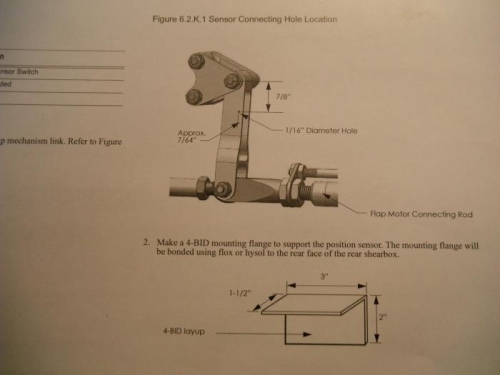

FLAP POSITION SENSOR INSTLLATION
FLAP POSITION SENSOR INSTALLTAION.
DRILL A 1/16 HOLE BELOW THE TOP BOLT HOLE OF THE FLAP MECHANISM LINK.
REF TO FIG 6.2.K.1
