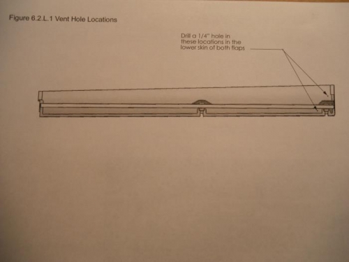

FLAP VENT HOLES
THE FLAP REQUIRES VENT HOLES TOALLOW FOR CHANGES IN ALTITUDE ENCOUNTERED DURING FLIGHT OF THE AIRCRAFT.
DRILLL 1/4 HOLES AT THE LOCATION SHOWN.
ENSURE THE HOLES ARE PLUGGED AND PROTECTED DURING ANY BODYWORK OR PAINT OPERATIONS.
ENSURE THESE HOLES ARE OPEN AND CLEAR AFTER ANY BODYWORK.
ENSURE THE HOLES ARE OPEN AND CLEAR BEFORE FLYING THE AIRCRAFT.
