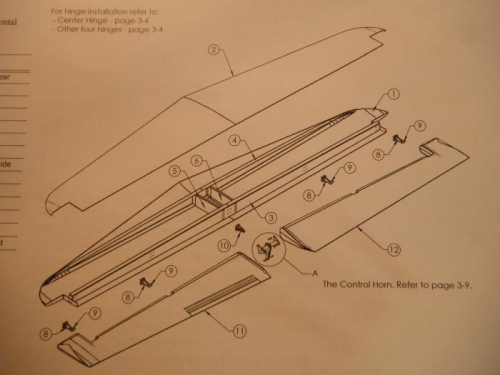

3.2.G
INSTALL AFT HINGE PIECES TO ELEVATOR
ASSENBLE FOUR AFT HINGE ASSEMBLIES TO THE ELEVATOR.
FIG 3.2.G.1.
PLACE HINGE ONTO ELEVATOR, ALIGN HOLES IN THE HINGE.
INSERT BOLTS (AN3-4A) WASHERS (AN960-10L) TORQUE TO 25 IN LBS.
