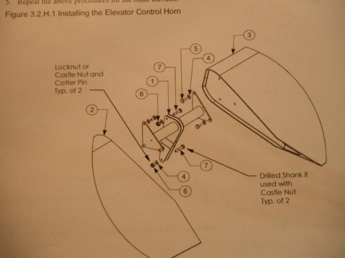

3.2.H
INSALL ELEVATOR CONTROL HORN
INSTALL ELEVATOR CONTROL HORN TO LEFT AND RIGHT ELEVATORS.
FIG 3.2.H.1.
ALIGN THE BOLT HOLES OF ONE SIDE OF THE ELEVATOR CONTROL HORN WITH NUTPLACES OF THE ADJACENT ELEVATOR
INSERT BOLTS (AN3-4A) AND WASHERS (AN960-10L) AND TORQUE TO 25 IN LBS.
REPEAT PRODCEDURE FOR THE OTHER ELEVATOR.
