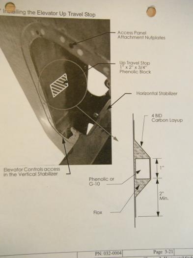

3.2.L.7
INSTALL ELEVATOR UP TRAVEL STOP
BONS A 1 -2-3/4 PHENOLIC BLOCK USING FLOX.
REF TO FIG 3.2.L.7 FOR LOCATION.
CONNECT THE AFT ELEVATOR PUSH PULL TUBE TO THE ELEVATORCONTROL HORN.
DETERMINE AND MARK THE LOCATION OF THE ELEVATOR STOP.
BOND A 1 -2-3/4 THICK PIECE OF PHENOLIC TO THE STERN POST USING FLOX.
ALLOW FLOX TO CURE THEN GRIND THE PHENOLIC UNTIL AN UP ANGLE FOR THE EVEVATORSOF 22.5 +/- 0.5 DEG.
GRIND THE PHENOLIC MORE THAN THE AMOUNT TO ALLOW FOR THE THICKNESS OF THE CARBON LAYUP.
USING FLOX CREAT A SMOOTH TRANSITION BETWEEN PHENOLIC AND THE STERN POST. COVER WITH 4 BID CARBON LAYUP
FIG 3.2.L.7
