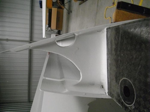

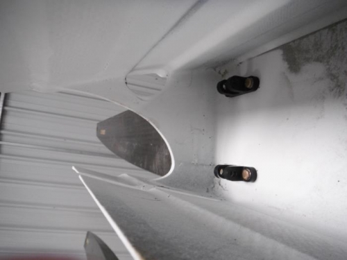

FLAP COVE CLOSOUT
FLAP COVER CLOSEOUT
CUT A PIECE OF CARDBOARD (TEMPLATE)TO COVER THE FLAP COVE AT WING ROOT.
WITH FLAP INSTALLED AND FULLEY RETRACTED.. ENSURE TEMPLATE FITS.
TRANSFER TEMPLATE ONTO 1/4 THICK 2 CORE 2 CARBON AND CUT TO SHAPE.
SAND EDGES UNTIL CLOSOUT FITS NICELY.
