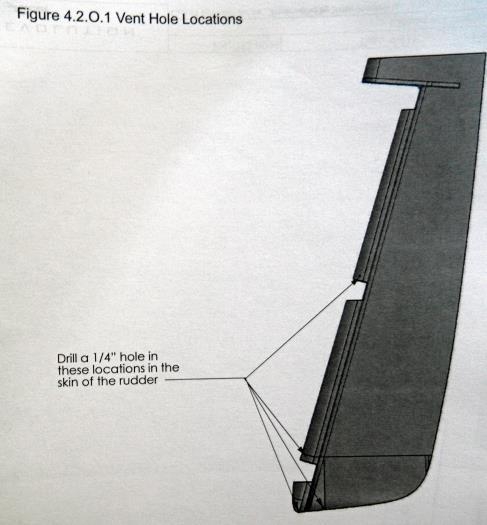

RUDDER VENT HOLES
THE RUDDER REQUIRES VENT HOLES TO ALLOW FOR CHANGES IN ALTITUDE .
DRILL 1/4 HOLE IN LOCATIONS DETAILED IN FIG 4.2.0.1.
LOWER HOLE DRILLED AT BOTTON OFF RUDDER TO ALLOW FOR MOISTURE EXIT
